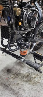

So I've made it fairly known my 208 is mildly built and has no hesitation to yank the front end off the ground, which to be fair the engine was designatwd high torque/winter/snow thrower use before I started tweaking it.
As is I've got a 9t on the Tav2 (6" driver, Yellow Comet spring in driven) turning a 56t on the axle for a final drive ratio of 6.22, a final drive ratio of 5.6 also stands right up.
The wheels are 1970's Takasago 185B-18 wrapped in 2.50-18 (40L rated) tires.
