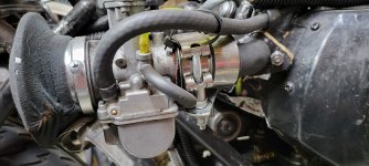

The fuel that sprayed from the carb didn't came from the power jet, it came out from the side air vents of the carb (see attached pic)
Any suggestions about the carb tune? I don't even know how to start :eek:

Fuel blowing from those vents is a stuck float allowing too much fuel into the bowl. Those vents have no functional purpose beyond keeping the air pressure in the bowl equal to atmosphere.
Hard start, and low range bog is an issue with the mixture screw adjustment, or pilot (in your case I'm betting both) and bog above 3/4 is main jet being too big.
If your carb has a D shaped slide and a Powerjet, it is a Keihin copy NOT a Mikuni, the link provided is for a 24mm PWK copy... DELETE OR OTHERWISE bypass or remove the PJ. They are for 2cycle not 4cycle and will make it impossible to properly jet and tune the main jet in your carb
A Koso 24mm PWK copy is exactly what I use on my 208 which goes like a kicked dog the way Ive dialed it in to play nice with the cam and other mods.
PJ is fully deleted and plugged so that the port doesn't cause inbound flow turbulence into the carb.
Give me your altitude and I can probably ballpark estimate your M/P jet sizes based on what mine ran closer to stock at 975ft and now at 2150ft

My carb does have a D shaped slide and a Powerjet, thank you for referring me to the correct carb type!
The carb has an adjust screw on the PJ, closing it all the will not do the trick? how do I delete & plug it correctly?
where I live it's quite sea level (15ft), what is the right adjustments I need to do?
It should, but because you're never going to need it, you'll be best to remove it entirely.
correctly is a matter of opinion. What I did was pull the brass barb from the bowl out, found a small self cutting screw to run in where the barb was, ran it all the way down before backing it out and notching it under the head so it would twist off when tightened.1000002061.jpg
as for the jet section, (like Bob said most aren't adjustable) I removed the top plug and the jet, then plugged it the same way before grinding down the carb body where the port was. I back filled the jet port with JBweld steel stick (not pulling the air horn to show), then contoured it to match the venturi.1000002063.jpg
The default for the mixture screw is turn it in to full seat (don't crank it tight, you'll do damage) then back it off precisely two full rotations.
My pilot at 975 was #39, yours is no doubt going to be the same if not one or 2 smaller for a bone stock engine at 15ft.
Tuning the pilot is fiddley... Guess a size, put it in and use the mixture screw to confirm larger, smaller, or dead on.
1.
