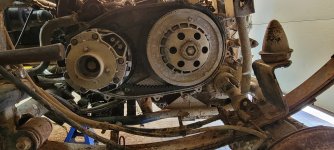

The primary limitation to their speed isn't really even the gearbox so much as its the heavy snow sled Spider style CVT just like my Kawasaki Mule has on its 617cc twin (FD620D)

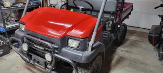

I know the Mule 3010 4x4 is not rated for better than 27mph but with just the speed limiter disabled she'll get along around 32-35 until met with an incline.

The FD620D is a liquid twin, and in my case it's stuffed into a 1350lb machine with H/L/R selectable 4wd and rear axle diff lock.
The transaxle is definitely a speed limiting issue in most karts because they are all geared for torque not speed but that big ole CVT doesn't help any

It's not my set up, it's a factory set up on a KAF620E Kawasaki Mule 3010 4x4
