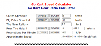

I mean if you are trying to do 5 mph at 3600 RPM with 22” diameter tires…
You would want an overall 40 :1 reduction from crankshaft to axle.
10T on a clutch to 60T on a Jackshaft.
10T on other side of jackshaft to 60T on axle.
36 :1
bob58o
SuckSqueezeBangBlow
8,864
929
Chicago-town USA
If the CVT doesn’t work out, perhaps try a 10T clutch and a 60T sprocket on the input of the gearbox (not sure what adaptalators are needed), then a 10T on the gearbox output with another 60T on the axle.
I’m not sure the reduction ratio of the gearbox.
1.3 :1 ?
So maybe something like a 10T to 48T and then a 10 T to 60T.
1.3 x 4.8 x 6.0 =
37.4 :1 overall ratio
Mossy slow 6.3 mph at 3600 RPM with 22” tires

I'm sure I'm repeating what others have said, but, 1000 lbs should not be a problem for that engine or TC to move it at 5mph, IF your gearing is correct. The issue is more likely that you're having to run it right on the edge of converter engagement to go that slow, which is what is going to kill your belt. To do it right, your rpms will have to be ramped up while moving that slow.
This engine can run a 25 ton log splitter... to crawl at 5mph you should be fine. The 420 won't solve your gearing and belt destruction issues... it might just make them worse.
Also, I'll second getting a comet brand belt.
This tool is helpful:
If you have the same forward/reverse transmission I do, you'll divide your clutch side sprocket by 1.3.... because the transmission gears it down for you, not up. So a 10T sprocket is effectively 7.7 teeth for the calculation. With 22" tires, 7.7T -> 60T comes out to 25mph at 3000rpm (I think you should try for no less than 2000 rpm continual speed). You will need more gearing.
You'll have to find the biggest sprocket you can put on your axle and not have clearance issues, and the smallest that will effectively work on the transmission. 85T (the biggest 41/420 I can find) would put this setup at 14-17mph for 2500-3000 rpm. If you drop to a 8T sprocket in the driver, it goes to 11-14mph for 2500-3000 rpm. I don't like such small sprockets, but maybe it'll work for this. That still doesn't get you where you need to be for 5mph... even 2000 RPM is 9mph. The lowest engagement for most of these TCs is 1600rpm. If you're at a lower RPM, you might not reach the full 1:1 ratio on the TC-Driven pulley, which may also help your gearing. The ratio from the TC starts at 3:1 and works its way to 1:1 (I would guess by 2500 rpm in a standard setup, but I don't know for sure). At 2K you might have a 2:1 ratio out of the TC/Driven pulley, so the 85T sprocket with a 8T on the transmission might work.
So, get that 85T and slap it on, it may work with the TC gear reduction. If that doesn't work, you might have to look at building a jackshaft after the transmission for an additional gear down step.
No question, I'd get the absolute biggest axle sprocket you can find and go from there.

Ideally I wanna do a jackshaft to go from 8-60 and then 9-60. That's gonna put us down close to 10 mph range. I know we'll have more than enough torque and be geared at that point and I'd like to think that between that, the Comet belt, and some of the part tips (I've already purchased the yellow CVT spring and some other parts to keep the CVT engagement down) it's enough to handle the weight........ I hope. We'll see!
