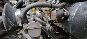

Yupp I settled on a TM24 due to it not having the powerjet like the pwk‘s.. I need to plum a boost gauge line and get a few simple clamps and I’m ready to test fire this contraption. 1ACF9EE5-91BA-4671-9A39-7F879F155157.jpegBDC6C53E-3D19-4063-A4D8-BC7F53B6A385.jpeg
